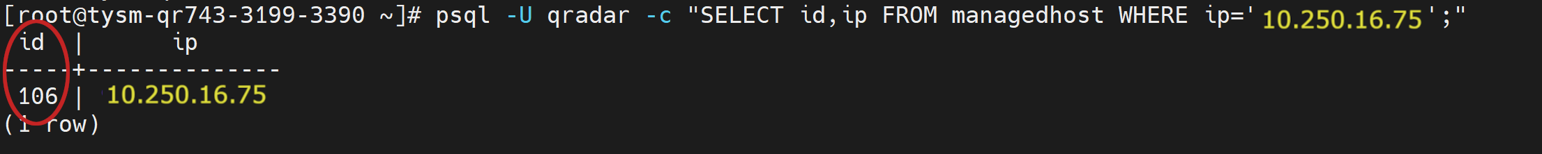

  2. To obtain the Managed Host ID of the target Event Collector edit and run the following command on the console:
    psql -U qradar -c "SELECT id,ip FROM managedhost WHERE ip='$<YOUR EVENT COLLECTOR IP>';"
    Note down the Managed Host ID.  In this example, the id is 106.
    Step 1 | Obtain the Managed Host ID

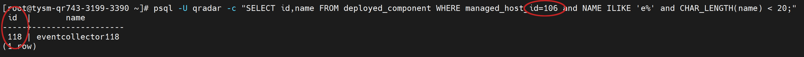

  3. Obtain the Event Collector ID based on the managed host ID from the previous step by editing and running the following command:
    psql -U qradar -c "SELECT id,name FROM deployed_component WHERE managed_host_id=$<YOUR MANAGED HOST ID> AND NAME ILIKE 'e%' AND CHAR_LENGTH(name) < 20;"
    In this example, the id is 118.
    Step 3 | obtaining the Event Collector ID

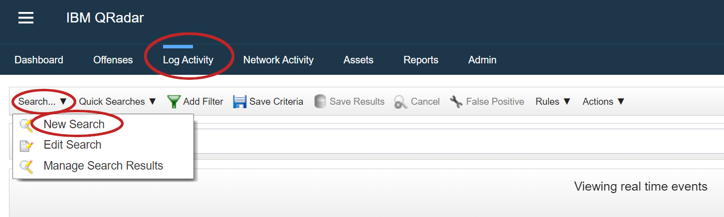

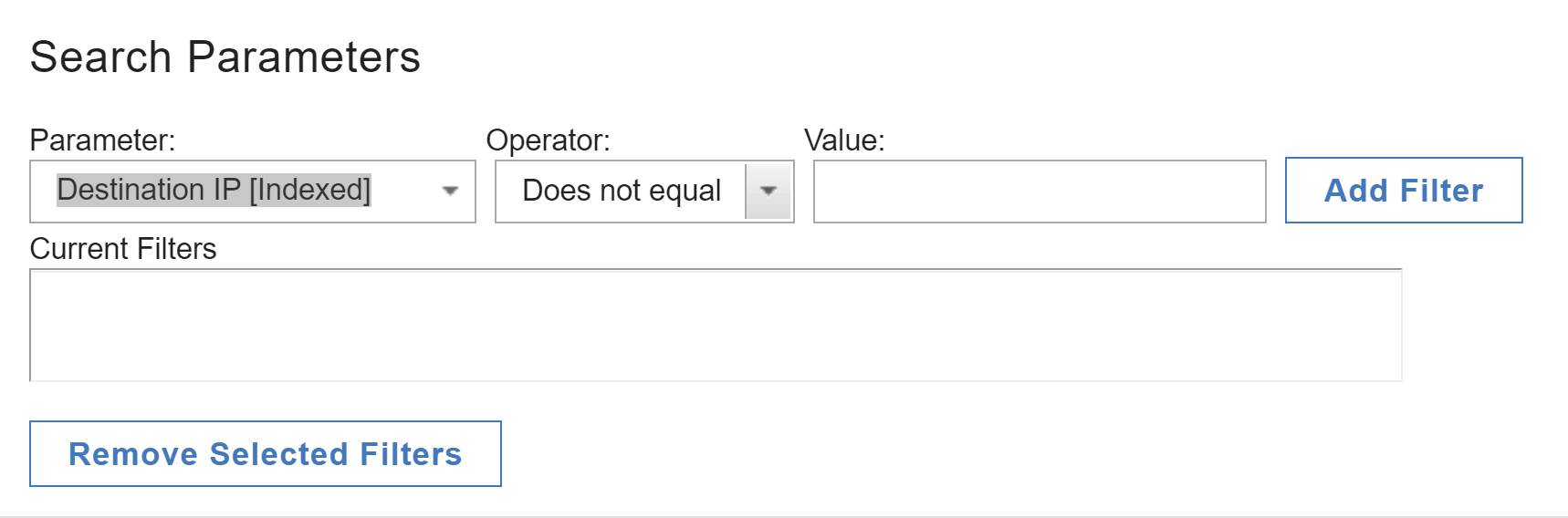

  1. To create a customized search, go to Log Activity > Search > New Search.Step 4 | New Search

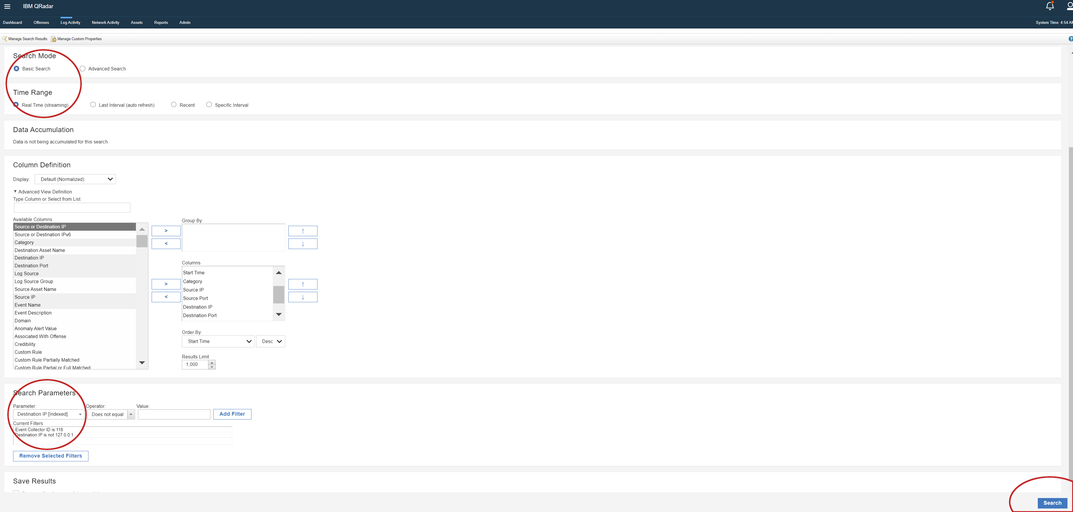

  2. Define the Search Mode, Time Range, and Search Parameters.Step 4 | Customized Search
    The second search parameter 'Destination IP is not 127.0.0.1' limits search results only to the Log Sources event data:
    Step 4a | Search parameters
  3. Run the customized search.

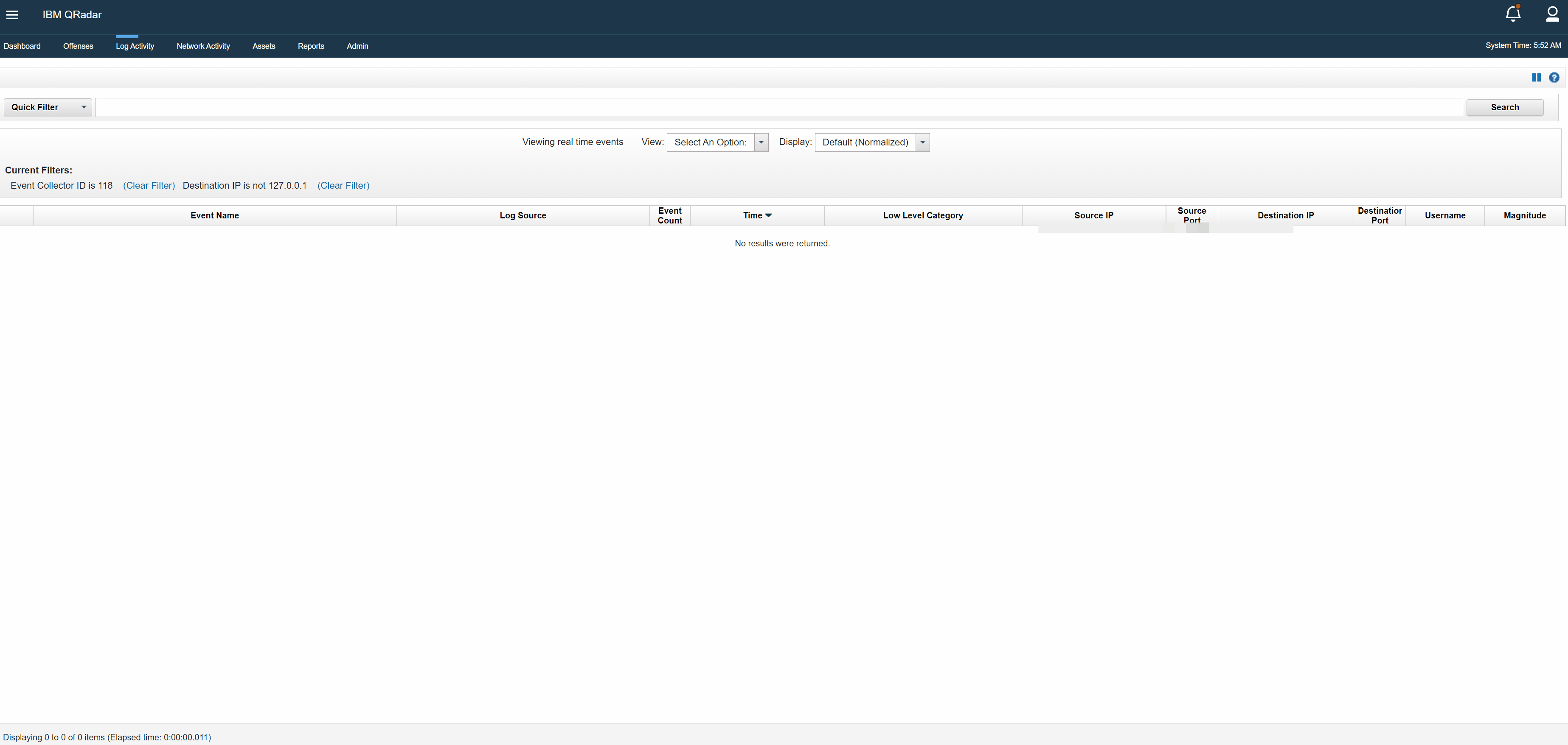

  4. Analyze the search results:Step 5 | Analyze the search results
    Result
    Events appear shortly after the customized search was run (same as on the animation). You can update search results with any other time frame (go to 'View' dropdown menu) to identify any potential event data gaps.
    Important: If the search returned no events, then proceed to Resolving the Problem.

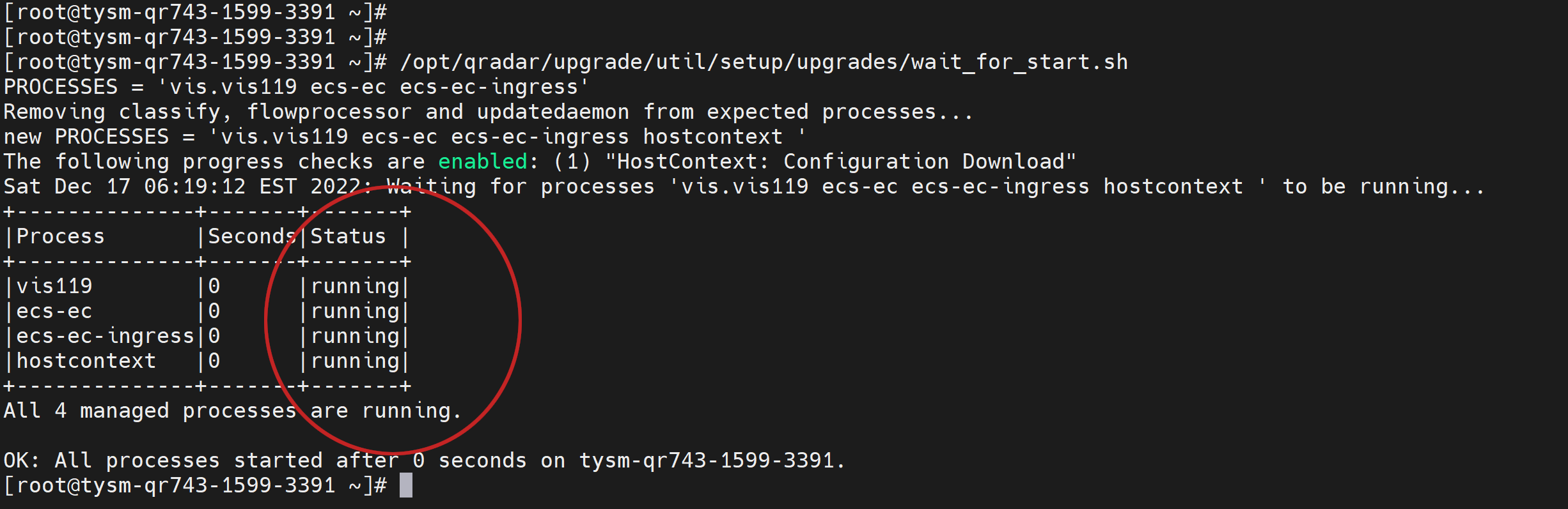

  2. Check whether the services are running on the target Event Collector:
    /opt/qradar/upgrade/util/setup/upgrades/wait_for_start.sh
    This example shows the services are running:
    Step 8 | Check EC services

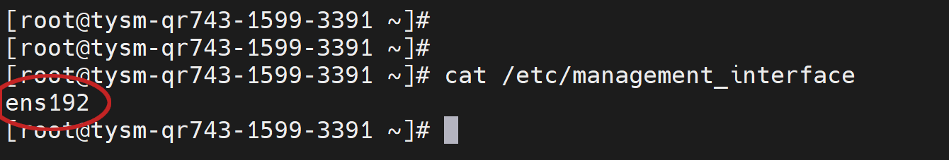

    1. Obtain the Event Collector network interface name by using the following command:
      cat /etc/management_interface
      In this example, the interface is ens192:
      Step 9a | an EC network interface

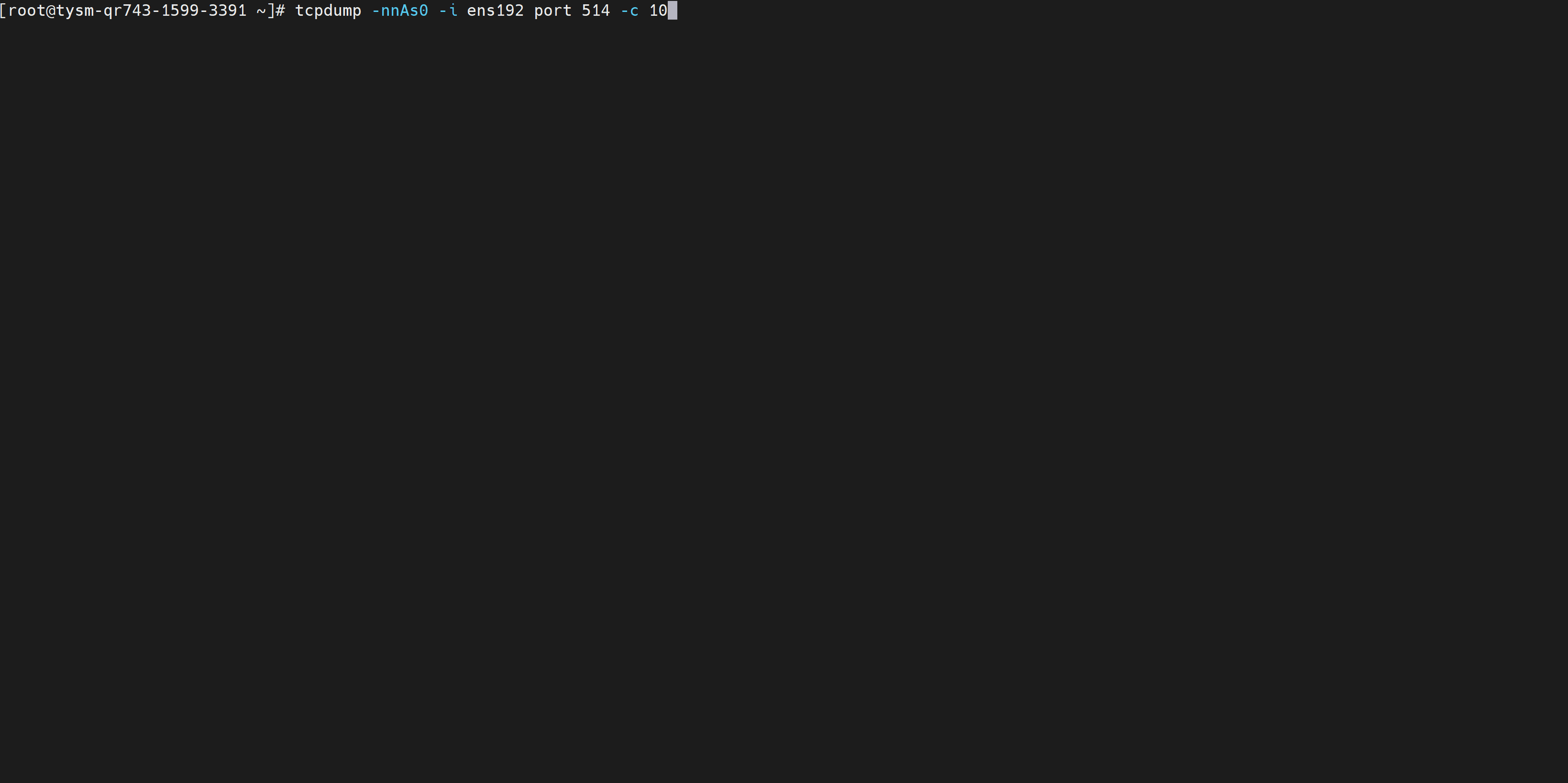

    2. Run the tcpdump command to check whether event data is reaching the target Event Collector.
      tcpdump -nnAs0 -i ${EC network interface} port 514 -c 10
      The tcpdump stops when ten network packets with the Log Source event data are captured:
      Step 9b | TCP Dump
    Result
    If the command returns packets, then the Event Collector is receiving event data.
    If no output is present, then the next troubleshooting steps are to check the Log Source configuration and verify whether the network traffic from Log sources is not blocked by the firewalls.
