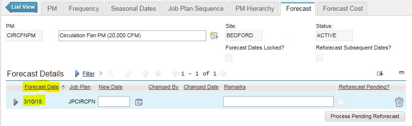

  • If there is a Forecast for a PM, which has populated a Forecast Date on the PM, then a Work Order will generate on that date.  The Work Order will generate on this date regardless of
whether the PM is set up to only generate Work Orders when a meter frequency is reached.  The summary is that the Forecast Date overrides any meter frequency that is currently applied to
the PM.

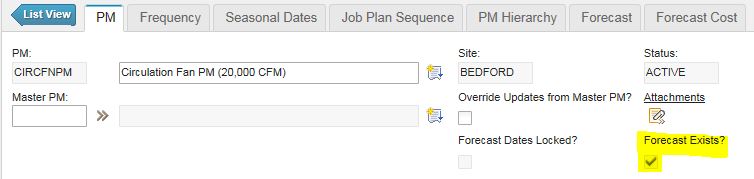

*In the above example, the Forecast Date will overrule either frequency, and the Work Order will generate upon the Forecast Date.  (note that the Forecast Exists checkbox is selected):
