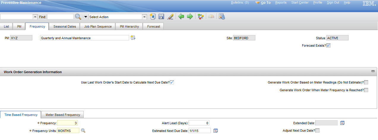

Define and Identify a Sequence Value
Taking advantage of Job Plan sequencing will provide a concise way to ensure that the correct maintenance gets performed at the required intervals, while minimizing and/or removing the manual administration of the PM and Job Plan records themselves.  The summary of the method to create the proper sequence is to assign each Job Plan to a specific position in a sequence of PM Work Order Generation.  Let me contextually define what a sequence is. The sequence is based on the frequency of the PM.  The PM shown below has a frequency of 3 MONTHS.  This means that each 3-month period is 1 sequence.  If we wanted to insert a new Job Plan into the sequence every 12 months, this means that we want to insert that Job Plan into every 4th sequence.  In other words, sequence 4 is the 4th three-month time period.  image
In the Job Plan Sequence section of a PM record, it is not necessary, or typical, to see each number of the PM Work Order generation sequence.  It is only necessary to enter the sequential position of the constant, and to enter the sequential position of any variables.  For example, if a different Job Plan needs to run on every 4th time that this PM generates Work Orders, then 1 is constant (runs on every frequency of the PM) and 4 is the variable (runs on every 4th frequency of the PM).

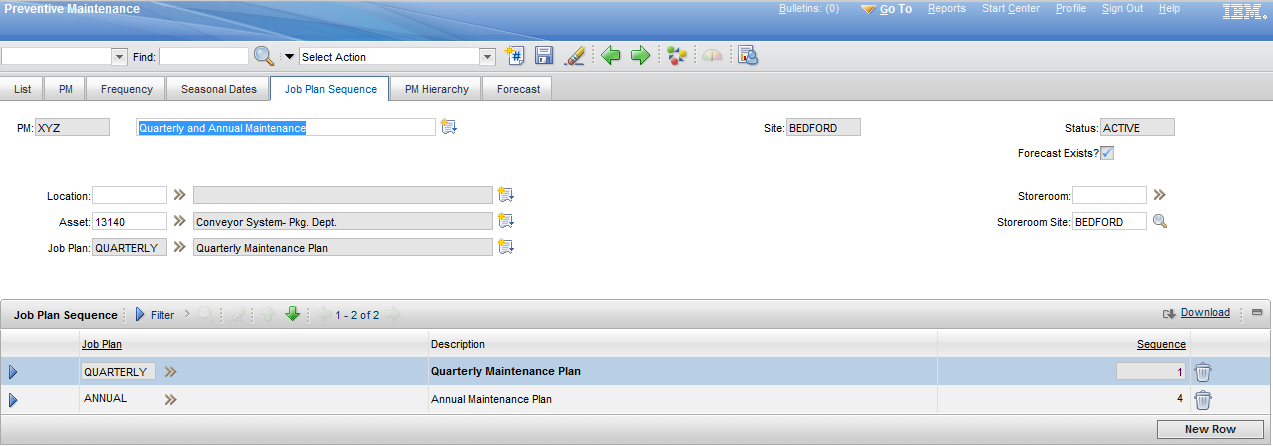

To Use a Sequence Value
My example scenario is one whereby quarterly maintenance is required on an asset. Additionally, an annual maintenance procedure needs to be performed on the same asset.  The Quarterly Job Plan will run during each PM Work Order Generation, so it's sequence value is 1.  The Annual Job Plan will run once every 4th generation of the PM's Work Orders; so it's sequence value is set to 4 to make this happen.

So here's the schedule.  The Frequency of this PM is set to 3 MONTHS, with the initial value of the Estimated Next Due Date field set to 1/1/15:
PM Work Orders will generate on 1/1/2015  - Job Plan "QUARTERLY" is used to populate the Work Order tasks
PM Work Orders will generate on 4/1/2015  - Job Plan "QUARTERLY" is used to populate the Work Order tasks
PM Work Orders will generate on 7/1/2015  - Job Plan "QUARTERLY" is used to populate the Work Order tasks
PM Work Orders will generate on 10/1/2015 - Job Plan "ANNUAL" is used to populate the Work Order tasks
The configuration of the PM Sequence rows is shown below, to make the schedule above happen:
You can also view the manual sequence, that shows the names of the Job Plans that will get used for the Work Orders by going to Select Action | View Sequence; this will provide a validation of the schedule that will result from the Job Plan Sequence:image
