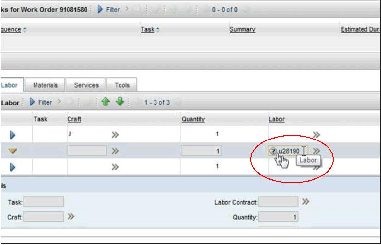

Good Question... You may have noticed that, on occasion, a question mark icon appears in the field where you've entered a value in some Maximo applications.
The shortest answer is... This is not necessarily an error message; this is a conditional GUI response to the value that has been entered in a field.  If a value is entered, and is then persistently displayed along with a question mark, then this is a valid value, but there is a warning, or additional information that is related to the entered value.
The longest answer is...  if a value is entered, and a red X appears instead of displaying the value, then this is an error message, and the value is an invalid entry.  In both cases, a further explanation of either the warning or the error message will be visible if the User clicks on either the question mark or the red X.
In the example below, it is likely that the type-ahead feature entered the completed value of "u28190" as soon as the User entered the first few characters.  Additionally, it is likely that there are several available records with a similar string of characters, such as would be displayed in a Select Value/lookup.  In this case, the question mark would present a lookup-type list which the User could then select a more appropriate value if desired.  If the User is satisfied with this value, the question mark can be ignored, and the value will subsequently be saved.  image
