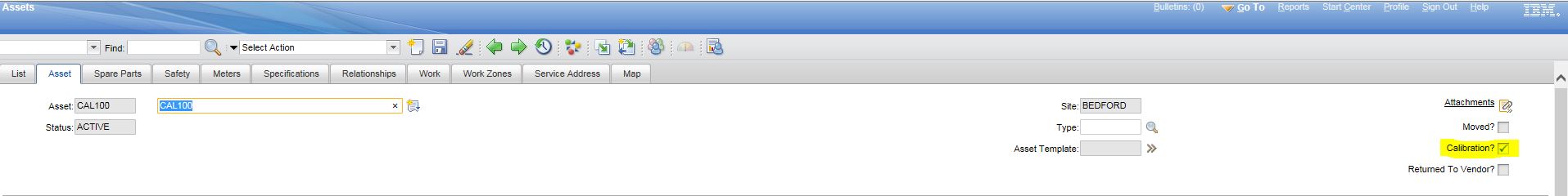

Depending on which Maximo Feature Pack that you are using, you may run into an issue with the View Asset Status History dialog in the Assets application.  There was an issue discovered with the 7.5.0.x Feature Pack versions whereby the status history data for Assets would only display data for Calibration assets in the View Asset Status History dialog within the Assets application:
This was corrected via APAR IV65532, which was made available after the release of the 7.5.0.9 Feature Pack, but some clients may be running into this if the Maximo environment is not using one of the most recent fix packs.  There is, however, a manual workaround that can be implemented to get around this issue until your environment is updated to a more current version.
The issue stemmed from when the Calibration product became integrated with the base Maximo product - this introduced the design component of having the the asset status data stored in the PLUSCASSETSTATUS table instead of the previous design of using the ASSETSTATUS table.  The issue being discussed here was caused by the GUI (the View Asset Status History dialog) reading the asset.xml, which initially had some incorrect code still intact from when the Calibration was not integrated.  The result of the code (shown in the xml further below) will only display the status history for assets flagged as Calibration.
