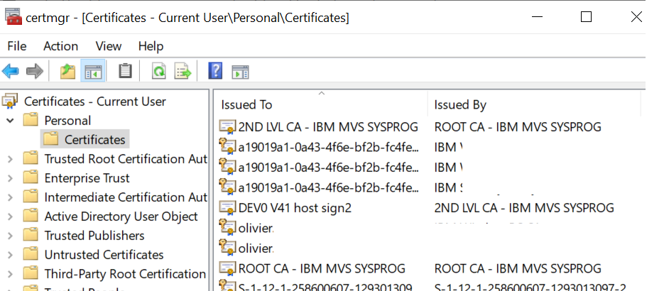

MSCAPI
HCE mscapi
HODJSSEImpl.initContext : browser keystore
Certificates are stored under Personal in the Windows MY keystore.
It can be checked using command:
certmgr /s my
certmgr
cert

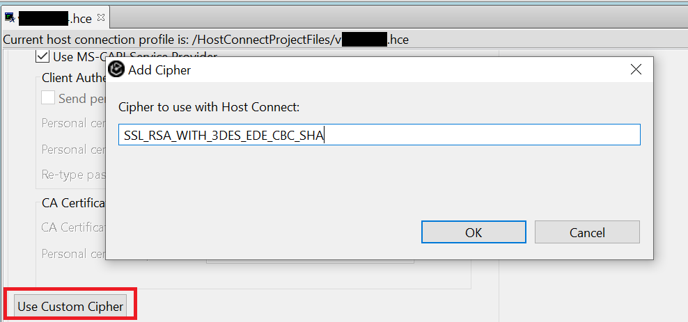

Incompatible cipher suite
You can add a cipher suite on the Host Connection Emulator configuration by clicking the button "Use Custom Cipher".
HCE custom Cipher
The new cipher suite appears in the console log:
HODJSSEImpl.performCipherCustomization() 1: Entered : custom cipher html param :Add:SSL_RSA_WITH_3DES_EDE_CBC_SHA
